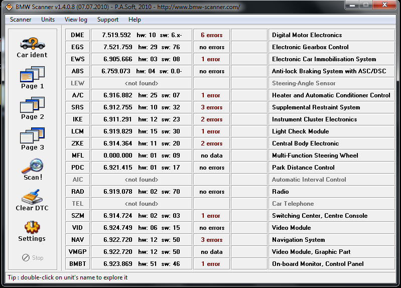

Ok lets break this down...
Bro base on your result why your millage shown on EWS was damn high (1 million+) ?
( EGS -> 1.423.886 29 57 00 10 60 43/99 56120 km WBAAM12070FN04681 000000 GS20
EWS -> 6.905.669 03 08 81 81 07 36/99 1025401 km WBAAM12070FN04681 FFFFFF EWS3
SRS -> 6.905.491 01 05 31 08 00 41/99 - FN04681 000000 MRS3 E46 )
xcrave;644262 said:
Told You last time my car is screwed transplanted monster....~~~~
xcrave, any update on the misreading of your car's ECU. appreciate some feedback.
Alex5522;644524 said:
Hahahahah... like i said when car comes from Japan you will get all sort of item inside... and yes it is 1 Mil+ hahahaha....
@ Jarance... stil the same... ECU Still giving same reading... was thinking to reprogram everything... but need a guide a very good one before i start... its just like flashing an electronic card i guess... but not sure if its possible... all i want to do is program everything to follow my original Milage + Update on the software without chip changing or module switch...

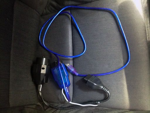

BTW ive read that you an actually do that (reprogram) By editing it with INPA/GT1 so now off to make my GT1 work with my car... ive just completed my Frankenstinish cable to make sure it work with my Ediabas/INPA Interface

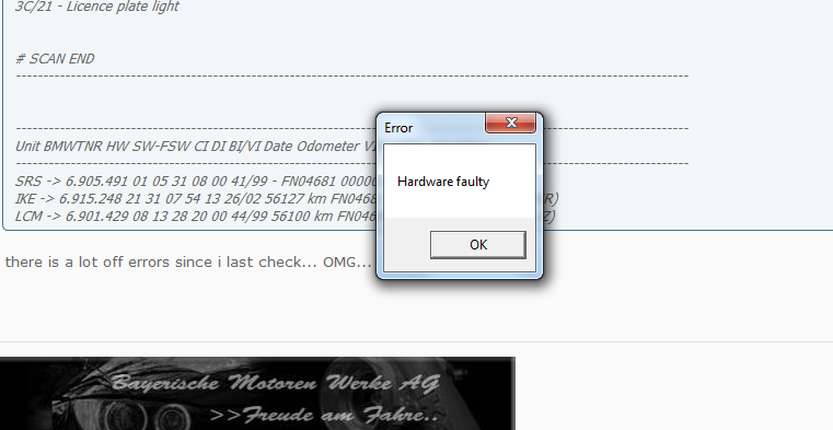

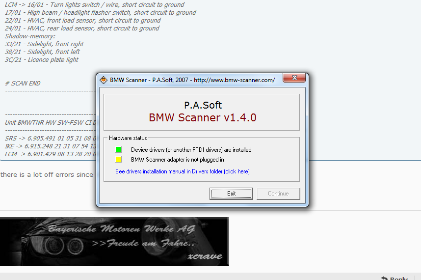

today got my bmw scanner from mr jarance through poslaju and so i started to install the software BMW Scanner v1.4.0 and update all the necessary file from the link given in the 1st page of this thread. so before i plug it in into my car,i need confirmation from all of u about something. this is the screen shot from my lappy where i installed the software.
#1
this is when i click on the software icon WITHOUT the scanner plug in into the usb.
#2
after i plug in the usb it turn to be like this.
#3

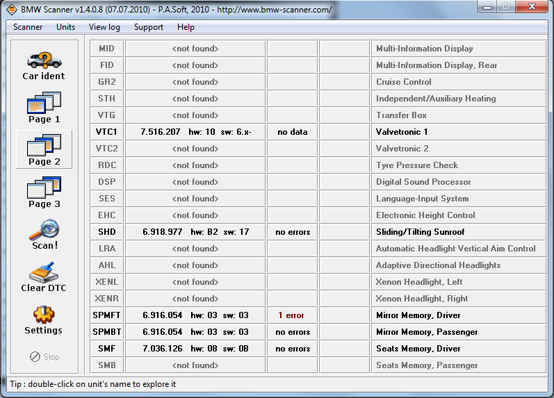

this is what happen when i click on the "hardware faulty" window and somehow its show that this program crash.this is the details :
Problem signature:
Problem Event Name: APPCRASH
Application Name: BMWScan140.exe
Application Version: 1.4.0.7
Application Timestamp: 2a425e19
Fault Module Name: StackHash_9441
Fault Module Version: 0.0.0.0
Fault Module Timestamp: 00000000
Exception Code: c0000005
Exception Offset: 006263bd
OS Version: 6.1.7601.2.1.0.256.1
Locale ID: 1033
Additional Information 1: 9441
Additional Information 2: 9441fd49dd7b645cf27ae7cd7aec385c
Additional Information 3: d2ef
Additional Information 4: d2efc7cb2a355edf0295a27138584000
#4
after that i try to open the software again WITH the scanner attach and only this window appear and the same error window appear after i clicking "ok".
so if i want to open the software again i need to remove the scanner first like picture #1.is that normal to happen like this?anyone?i still not attach it to my car as i need some confirmation about this first.many thanks :)
kursk, you need to plug the scanner into the diagnostic port first and turn on the ignition before you
start the program for the first time.
Please read my posting #2 in this thread.
thanks jarance. this is my error for now.
i wonder what CLEAR DTC means?and where to get live data windows?and how to clear those errors?noobs here :D
Click CLEAR DTC and you'll clear all your error codes (only those that are clear-able). Happy Clearing!
Errr... before you clear anything you need to know what the errors are... do post the Log here... so we all can see might have a critical problem that cant be solve by just clearing it...
where can i find the error log?view log?if that one,i cant access it.dont know why but it show some error "failed to set data for"
