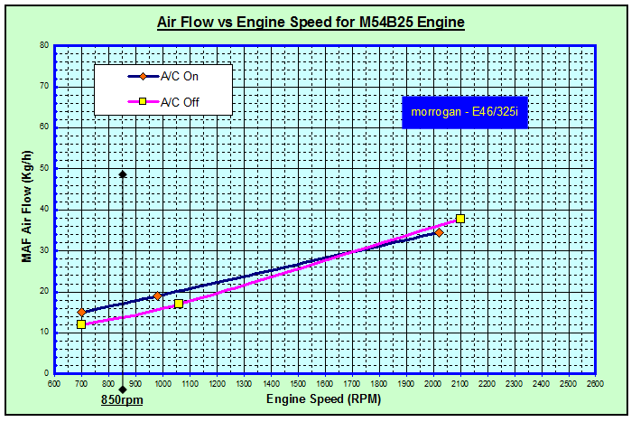

morrogan;644104 said:
Air-con off
RPM, MAF reading (kg/hr)
700,12.0
1060,17.0
2100,37.8
Air-con on
700, 15.0
980,19.0
2020,34.5
morrogan, I plot your data for the MAF. There is something wrong with the data. the curve cross.
I suspect some of your reading is out because you did not allow the rpm to stabilize for a few second before taking the MAF reading.
Your MAF reading is 12 kg/hr because your rpm is idling at 700 rpm whereas mine is 14.5 kg/hr idling at 780.
Sorry la, uncle Jarance. My typo mistake there causing the illogical graph.
Air con off - 3rd set of value should read: 2100rpm, 31.8kg/hr
Old already. Eye sight not good. 31 read 37.
My apology.

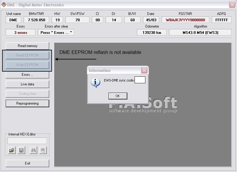

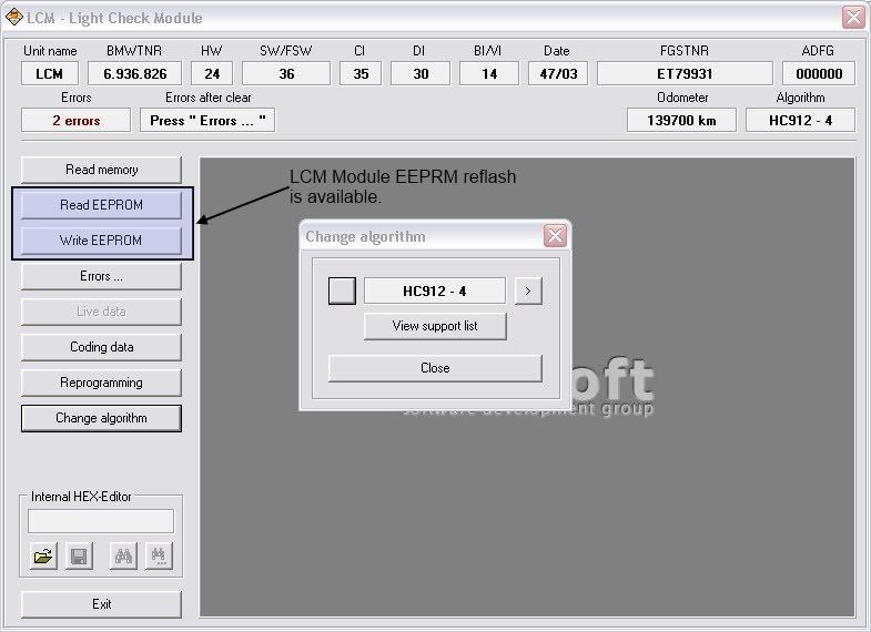

I check and find that DME reflash is NOT available for DME module using the scanner 1.4.
However, other module like LCM is available.
DME reflash - EEPROM Read/ Write - NO
LCM reflash - EEPROM Read/ Write - YES
