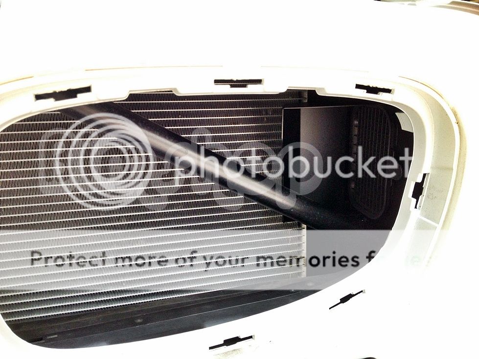

Based on what I understand from SC Manager, the water level should not be higher than this inlet. I am trying to figure out the air intake piping, but not quite clear. The photo as attached, which I believe should be the water that suck into the engine. But I need to confirm this again with my SA.

Silverbullet, their design is proven, no impact to the air intake.
Again, this shield is only prevent water splash into the air intake inlet, however, if the car is soak into the water pond or if the car drive through deep puddle, it won't help. It is again not a completely full proof, but it does some level of help.
The Injen Hydrolock shield believe to be installed on this filter per photo as attached. Any Sifu here please comments if I am wrong.
sh_Callum
based on your photo, the level of water must be really high to get sucked into the intake system. normally if we see that, we wont dare to drive through. after reading Alantiong's post, i'm beginning to wonder what is the real story here. Did the sensor get wet and refuse to start or water has indeed entered into the cumbustion system creating hydrolock. Brother Edmund, hope you get positive feedback from the 3rd party workshop.
Razibar, I had just confirmed with SA, in fact, the correct water level is slightly higher than the photo that I posted earlier. Yes, the water level is quite high indeed.
