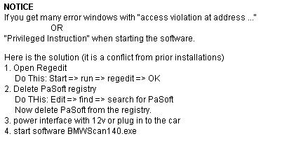

OK found this on the web about "Privileges Error". It look like you have a previous installation in your computer.

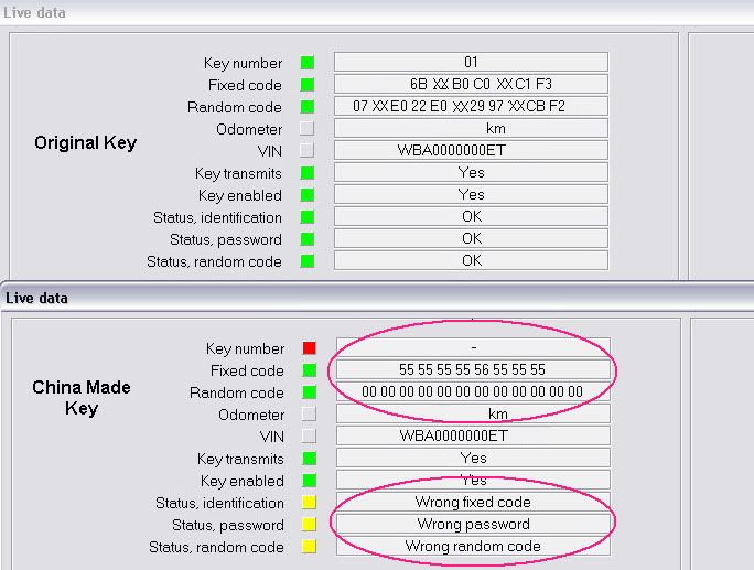

Anybody know how to solve the EWS problem.
Bought a key from china. Key can sync with the car. Can open/close the door lock but cannot start car.
Check the key information and found the info is different from the original. Anyone know how to resolve this issue.

Jarance,
Did you use the 'hold unlock button press lock button 3 times' method with the new key ?
The key come already cut ?
IanDaddy;611048 said:
Jarance,
Yes, I use 'hold unlock button press lock button 3 times' method to sync the key to open/close the door.
No lar, the key is uncut. I got it cut in Klang for RM60. There are cheaper place but after considering the petrol cost, it come to the same.
New key at the bottom.
Did you clone the old key's transponder? Without the transponder, you can only open doors and not start the car.
