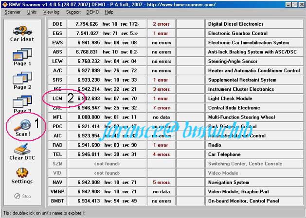

Hi Sifus,
I am worried about one thing. Under Live data, my Status VANOS Active is "No" instead of "Yes". Is this an issue I need to look at for my M54b25?
Please advice.

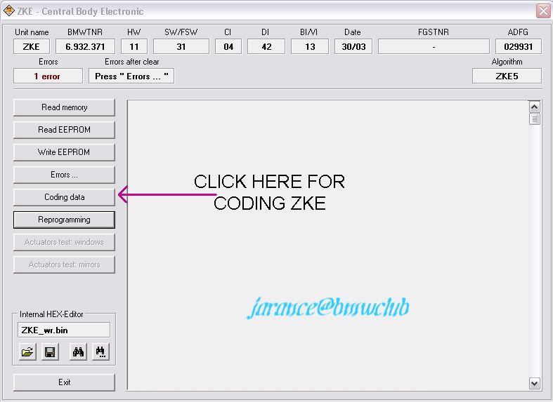

haywire;610704 said:
First, go into "live data' and see your engine idling speed etc. This is mostly for your amusement only.
Then go to 'Coding' in each of the module menu. This is the example for the ZKE module:
And another one for the PDC:
Change the options to your preferences.

A: ha..ha.. 2 of the people here also the same problem. So far no feedback on the solution. It could be related to the fuel system.
for alarm 7E code, have a look at item 20.
