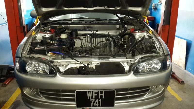

Updating my wiralution going for heart surgery.

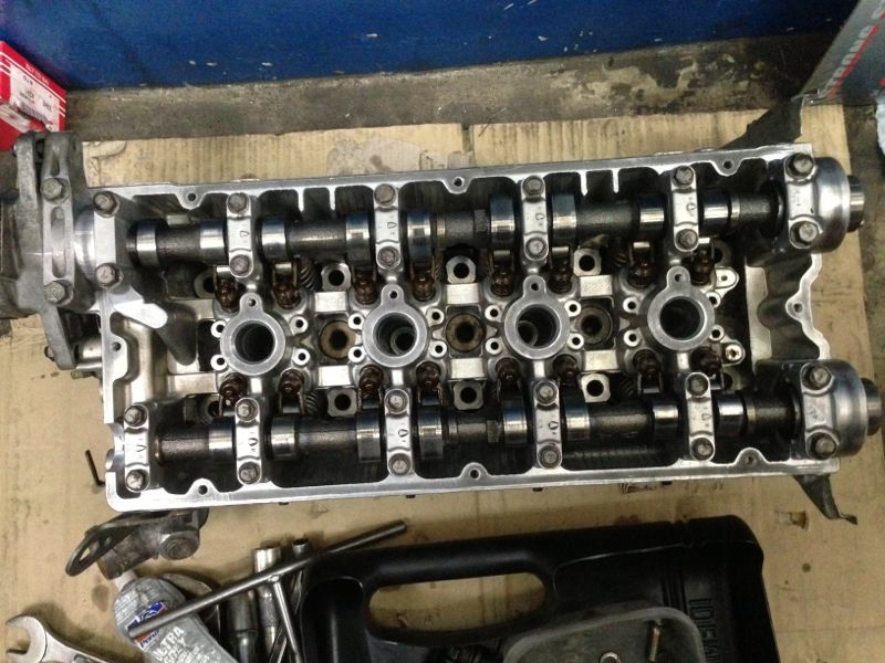

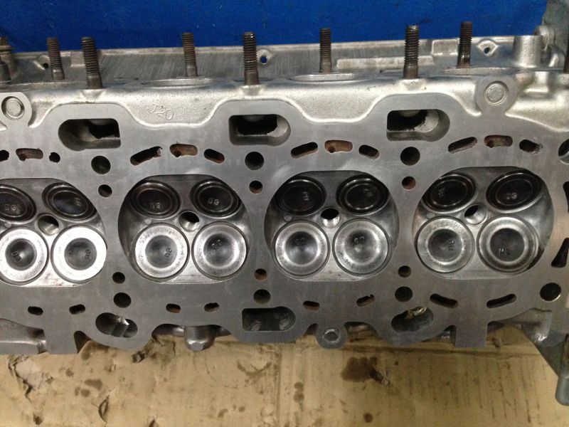

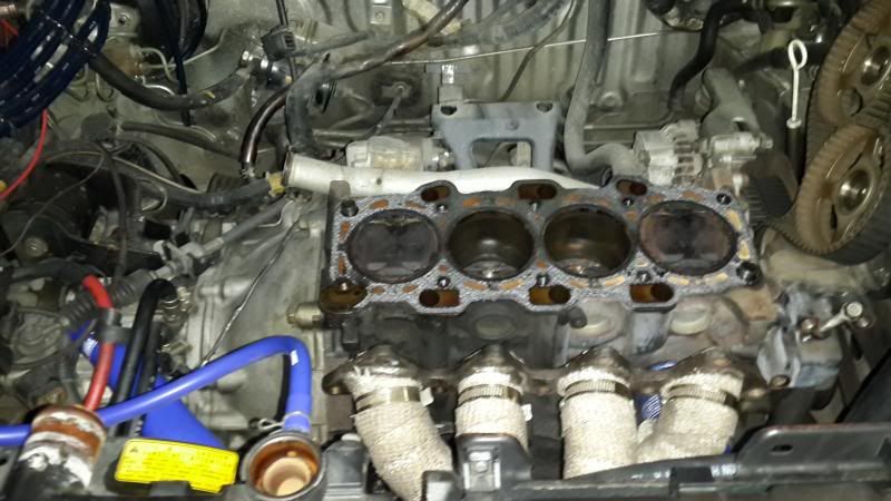

The engine head taken out and send to engineering for grindvalve and skimming

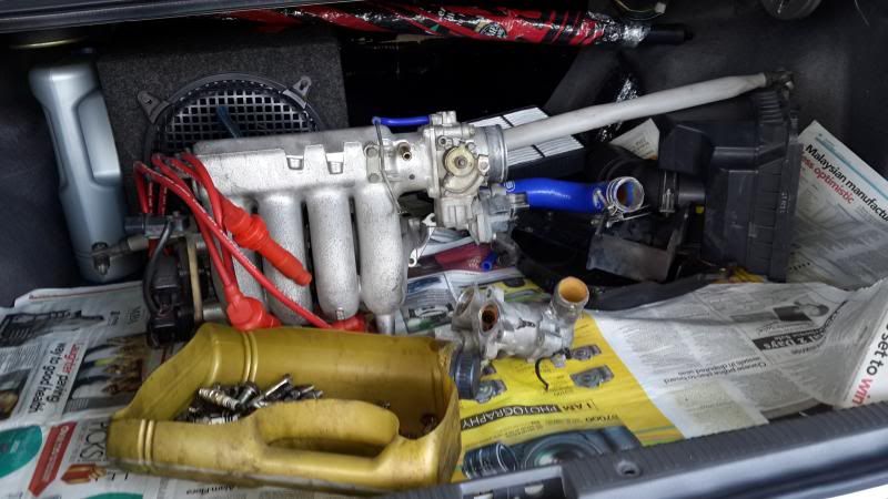

Clean the intake manifold and other parts and keep inside the boot

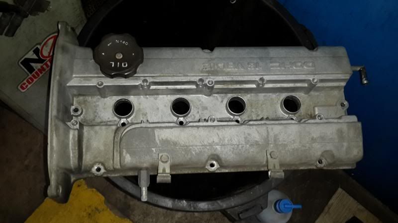

Clean the valve cover to spray.

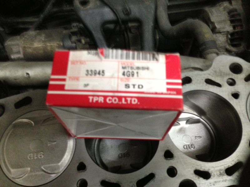

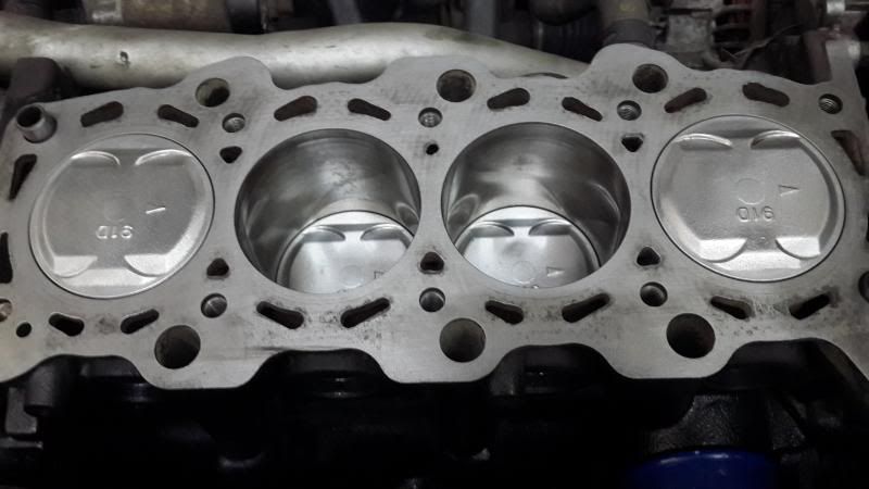

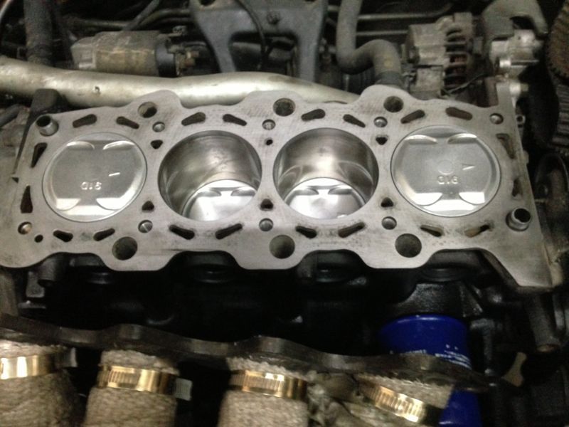

After installed the piston, new ring and conrod bearing.
After jilat the piston head
