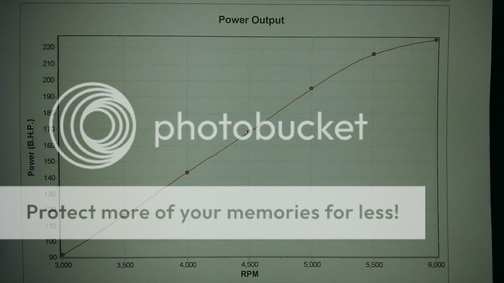

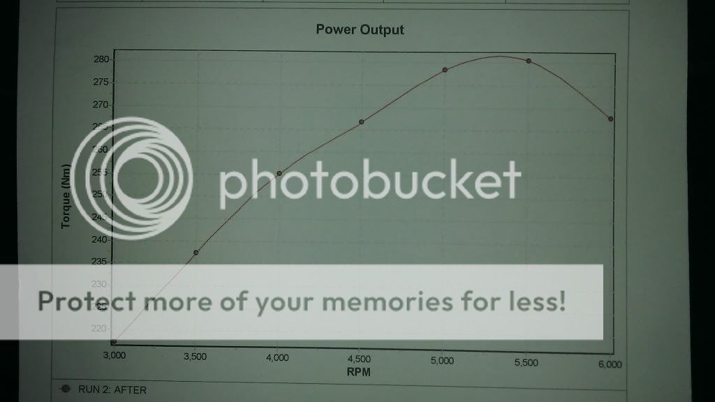

ramsing;673846 said:morph....dont forget u r driving a na car la. as pussy said, the tq peak is about there. normally hp/tq intersection is at 5450 rpm or thereabouts. if u change to m3 cams, u will only bump it higher, but wont do anything low down. to get 350nm at 3k rpm, u need to either add more displacement, or add boost. hahahaha.
wah, with the money u spent on the stroker etc, u could have prob gone the same way as fandango and got 350nm now, with a turbo.racun racun.....
pussy;673818 said:looks like a correct torque curve after your OBD1 manifold conversion... the old torque curves have been adjusted/moved/missing due to it, and adjusted into HP gains..
but's its good, cos your power(hp) and torque goes up till 5400rpm... smooth all the way..with the M3 cams, you will see a spike !!
er, where is your HP chart ?
