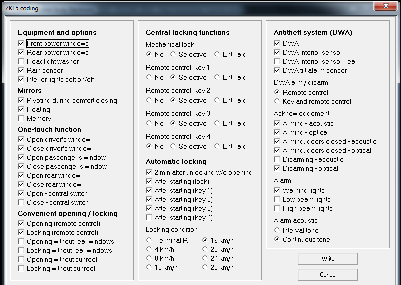

1. Live data working perfectly, e46/05 msport local
2.Manage to change the service interval to 10k
3. I cant get the lock/arming beep sound like u say. did i click something wrong? the 2min after unlocking is working.

OK, try this test.
1. Lock your car with the remote key. (i.e. arm the alarm)
2. Open the door using the key at the driver side. (enter into car without disabling the alarm)
Does your alarm goes OFF? If it does not, then your alarm might be having some issue.
The arming "sound" comes from the same buzzer and not from the car horn.

mmm ... is motion sensor comes as standard with the alarm? Is it possible to have the alarm but with out the motion sensor from factory?
Mine is local ab car.. same batch with Jarance. I rmb my bro once told me tat bmw cars doesnt comes with alarm.issit?
Anyway, i did wat Jarance suggested, no alarm sound but the side marker was blinking.. could it b my siren spoiled?
did you check the 'acoustic' option for the alarm on the scanner software?
Some Japan import BMWs doesnt have alarm and PDC, dunno why. My car certainly have one.
Haywire bro, i posted a screenshot.. i checked all, updated. But still no beep sound when i lock d car. Can u see whether i miss out abything? Thks
mine same batch with Jarance, if he has alarm, mine should have rite? Or issit the siren was disabled?
For some cars that i did the setting also don't have the beep sound, i mean the E38 lah. Like what Jarance told to test the alarm system first is the best. If no sound when the alarm triggered, u should check ur siren..maybe the connection is not good.

Alex, you are right.. i have the same error code. " Anti theft alarm system : siren,radio interior protection, tilt alarm sensor or wire STDWA shor circuit"
what does it mean?
what does it mean?
Yalor me too with the error code la.. Can someone help to solve this problem pls...
