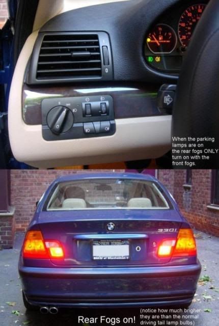

That's for your fog lamp... specifically, i think it's for the rear ones... the one to the left of it on the other hand is for the front... try it out at night to confirm which is for which...

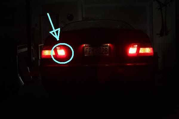

Like this:
Most of the conti car got this rear caution light. Japan car talak... This is the caution light for those follow at your bck i guess, and it was at the Rear Right Side Only. Especially at the night.
Pls correct me if im wrong...
It suppose to be "Light UP" on ONLY one side. for Malaysia, it will be on the RIGHT hand side. If both lights are ON, it will be confuse as brake light. That why it is always ON on the DRIVER side when the rear fog light switch is turn ON.
