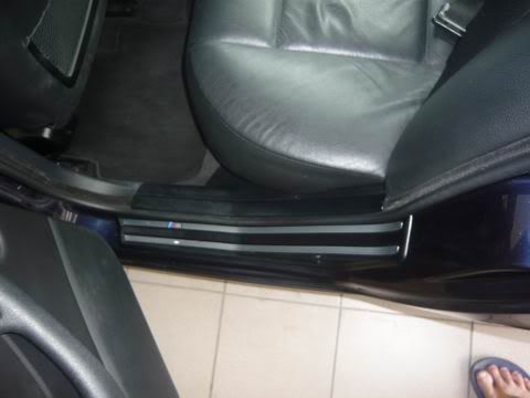

bro, what colour is your exterior trim as shown below?
