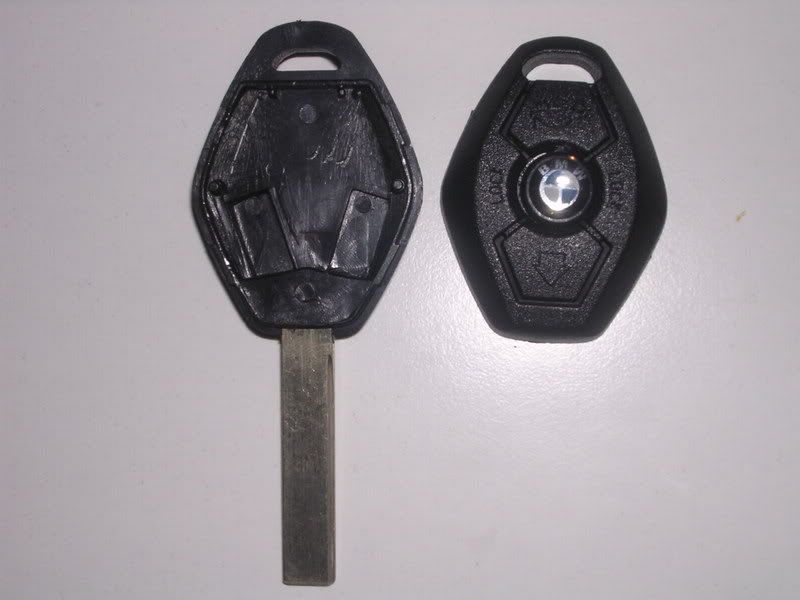

dummy key from ebay.
Internal view of actual key from E46
