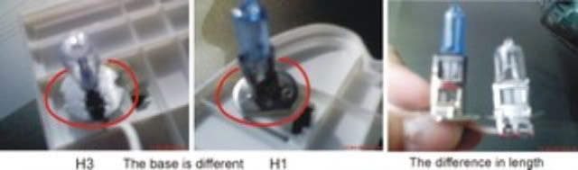

Whats the diff with H1 & H3 , ok I know the base is different and if not mistaken H1 is longer than H3 but what is the difference in performance, is H1 suppose to be brighter than H2 and so on..what is the purpose for the difference. Why am I asking ...recently I changed my headlights to an Eagle Eye brand for E34 with angel eyes b4 this I was using also non oem headlights with angel eyes but from DEPO...Im also using HIDs. To cut the story short, after installing my beam was weird, the centre was black and the sides were lighted.So I took it back to where i installed them to rectify it as I thought maybe they installed the bulb wrongly but no there was no difference but when they adjusted the bulb by pulling it further away from the unit only was the beam normal...discovered that my hid bulbs were too long and as such was not correctly focused by the projectors....so I contemplated to go without HID. Back home I dismantled the headlights to diy the lights back to normal and it was only then that i discovered this lamps were made to use H3 bulbs and those nuts who istalled it just cut the base of the HID bulbs (its made of plastic) to fit it when they should have known it was for H3 (or they didnt know??)...How I knew, I had some H1 bulbs lying around and was trying to fit them but it just wont fit and I suspected something was not right...so I googled and found the reason, the base for the bulb was for H3....but afaik the E34's uses H1so why were this made to use H3's ...this is where my question is coming from whats the diff with H1 and H3 other than appearance, Im sure there is a reason to create H1, H3's and so on...Sifus Pls your knowledge much needed here..to me at least.

thnks for the pics of the different types of bulbs available...but why the hell do they have to come out with somany different types???

The reason why you have a black spot is because the focal length is wrong due to the different in length.
That why when you move the bulb in and out, you will find that it will shine brighter or dimmer due to the focussing of the light that is being reflected by the reflector. Take note there is a focus lense for the low beam.
That why when you want to retrofit HID, you must get H1 HID bulb...
Jarance
thats the problem, when I use H1 got black spot bcos those Eagle Eye lamp was design to use H3 which is shorter than H1.
So when using H1 when pull further out the focus is correct but then its not in position already to sit on the base so hopefully the H3 bulb which is shorter should solve the problem...have ordered a pair which cost me RM180 and it better hell work.
