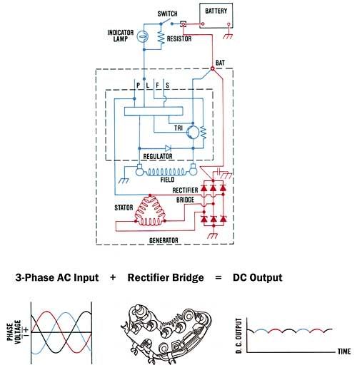

Additional Information about the alternator.
How does your alternator work.
basically, it convert an Alternating Current (AC) to Direct Current (DC) via a rectifier bridge.
The output voltage voltage will depends on the speed of the engine. Hence the faster the speed the higher the voltage.
The voltage regulator will regulate the voltage to within a limited for the proper charging of the battery. if this voltage is not regulated, the battery would be damaged due to overvoltage.
See pic below.

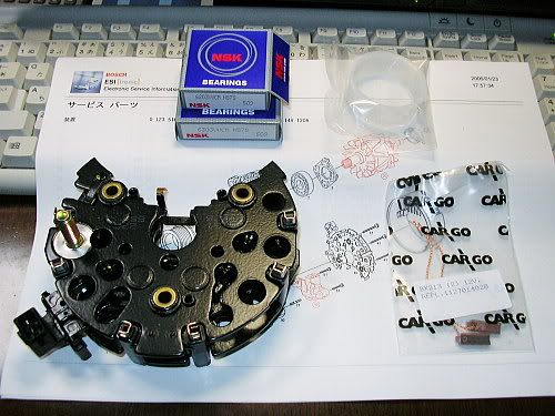

Here is a picture of a rectifier bridge and the bearing for the alternator.
You may need to unsolder the RB out if you need to replace the RB.

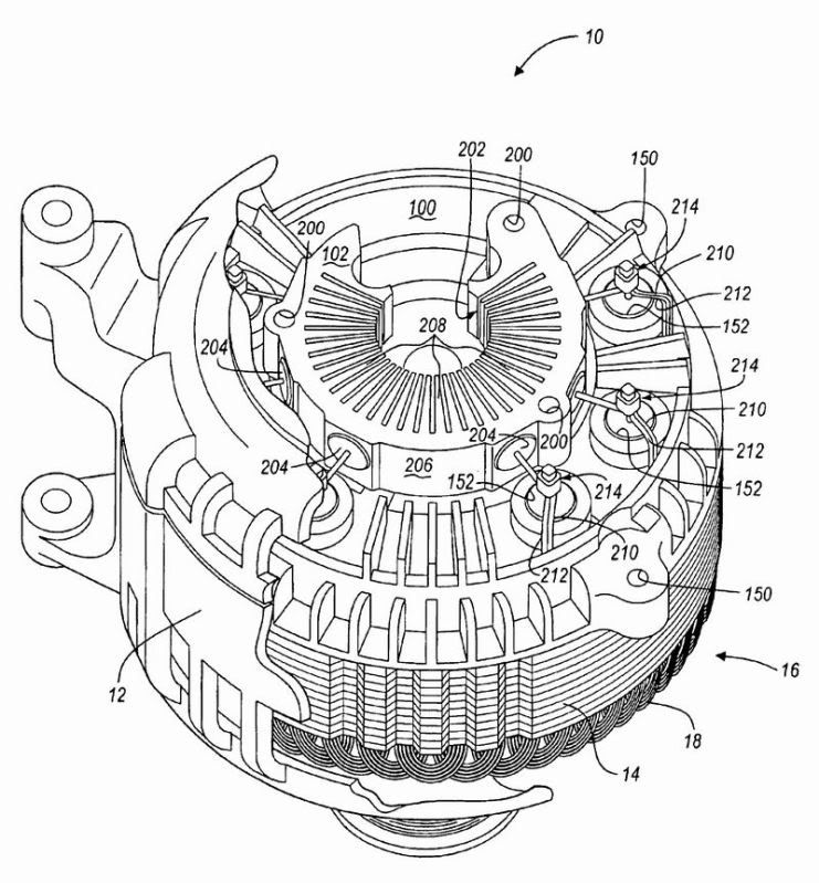

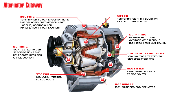

Very infomative. Mind to show a close look at the alternator component diagram.
Great, bro! good literature..
Jus little bit more request, da Borch diagram (wit Japanese wording one).
Tx.
