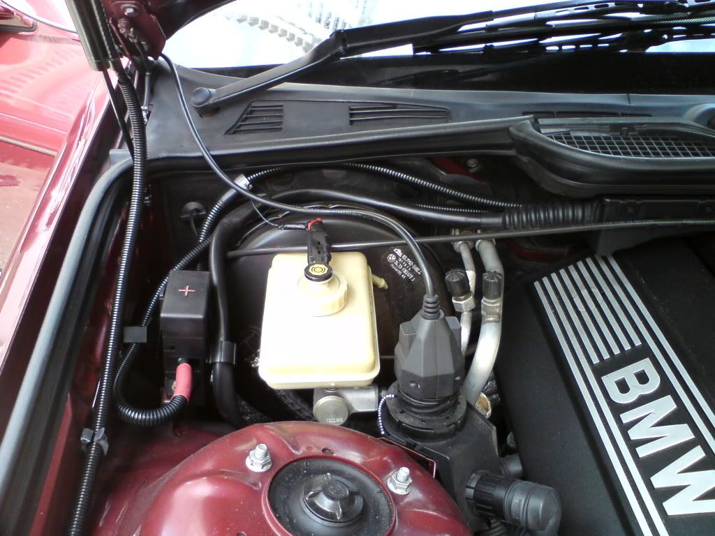

I heard lot of ECU remapping for the BMW using OBDII onward ......The method normally is u send ur car to the tuner and they will read ur car data and EWS thing and flash in another setting to ur car ........But recently i experience with the on car ECU remapping done by my fren.......According to him , on car remapping result is more impressive and significant as the new setting is according to ur car engine condition and mods tat hv been done like exhaust, filter , cam etc .....So normal remapping just a better mapping then a factory setting and on car remapping is specific for tat car only .........So just share my experience here cos i sent my fren E36 328 for the remapping ........The 1st thing to do is to install all the hardware to the car to read the car current air fuel ratio and others timing setting ......

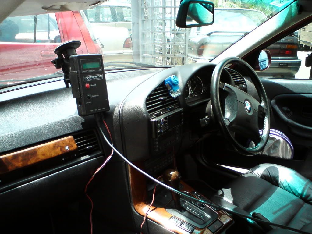

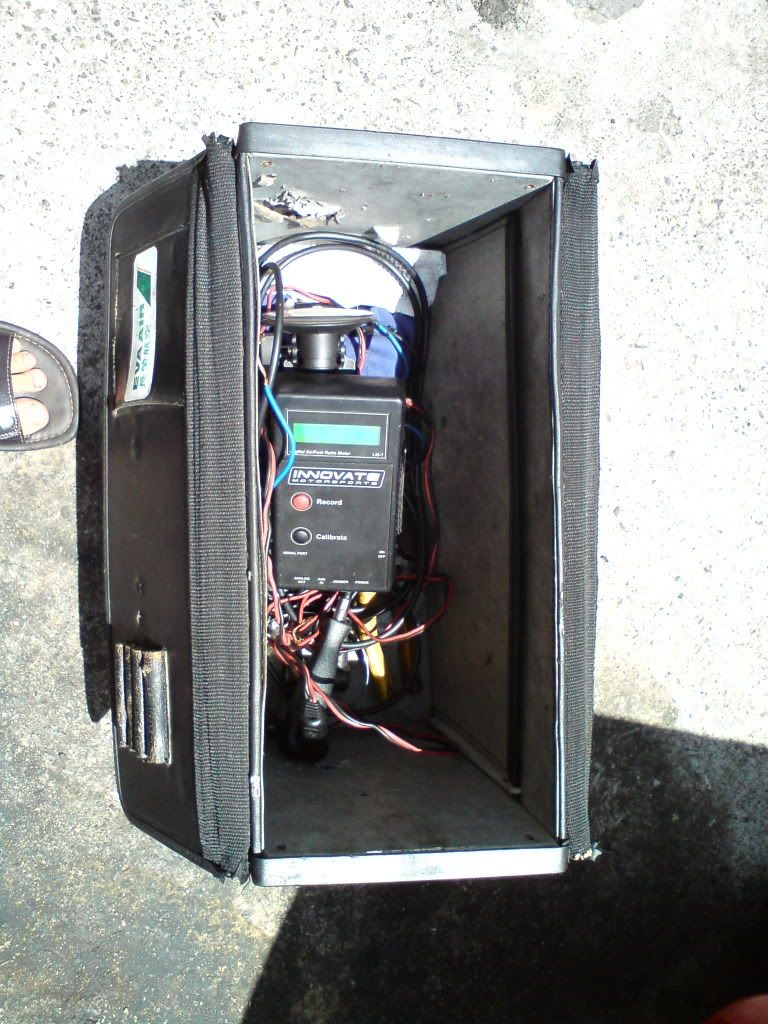

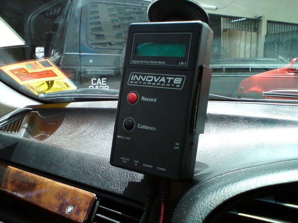

The tool - Air - fuel reader .......

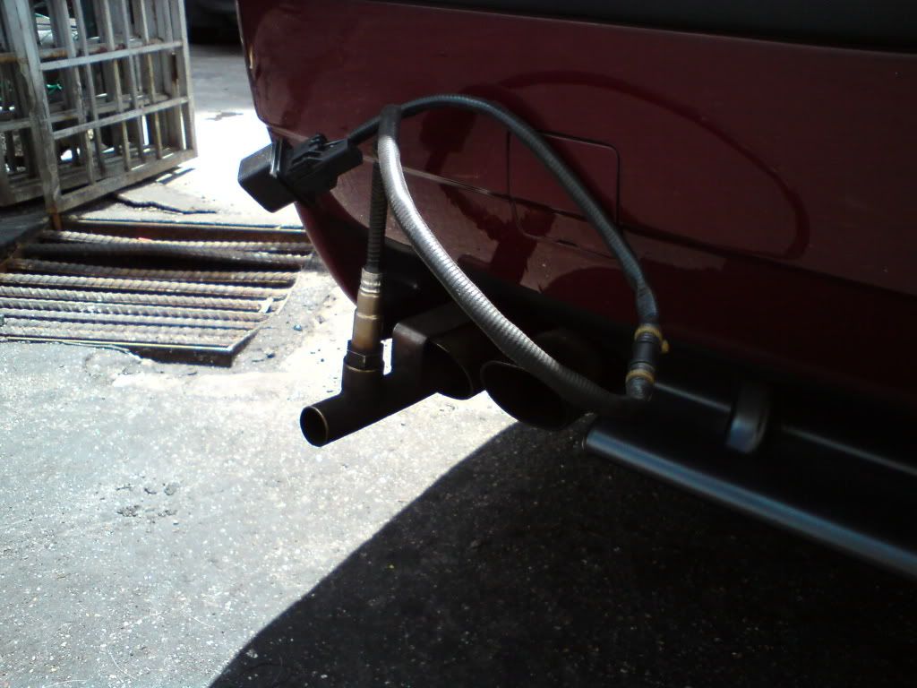

The sensor install to the exhaust .....
The air fuel reader stick on the windscreen for better viewing ....
Another view of the air fuel reader ......

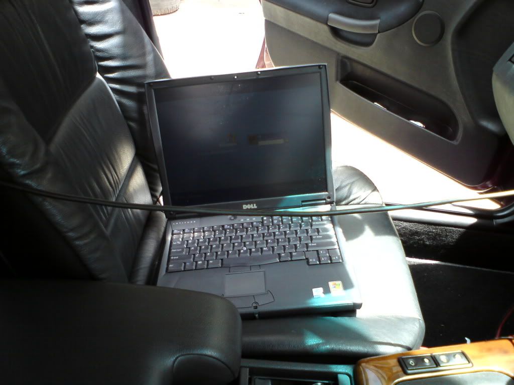

Main tool for the remapping .....
Connect the plug to the PC .....

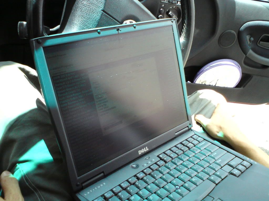

Tracking the factory mapping ......
After all hardware were installed, we run the car to see existing air fuel ratio .........Found out the car is running lean at the low end and running rich at the mid end and top end a bit lean as well .....
Car respond is not impressive due to d above mapping .......
