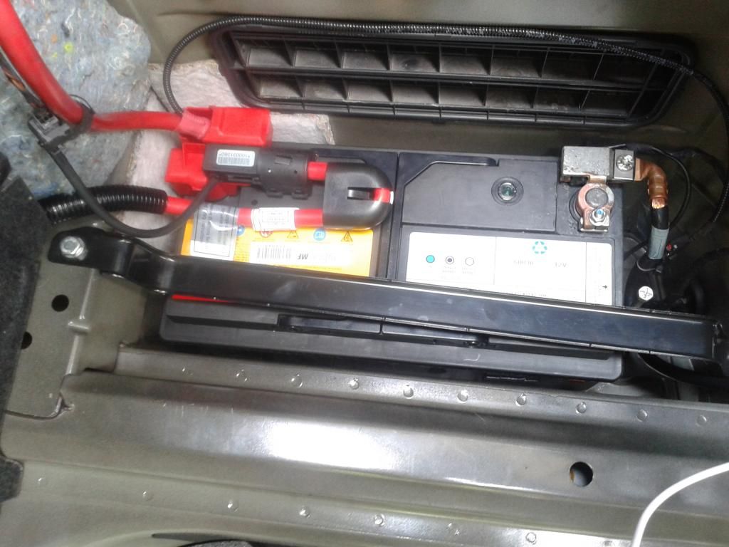

Siva, does it looks like this? Replaced mine from stock to Bosch S4 DIN 100 3 years ago

Zack 700, mine is also same size the brand starting from E cannot remember now i am a bit relieved i though the battery will be full size end to end my previous E39 batt was big.

My battery size DIN 100:
CENTURY bought for rm550
