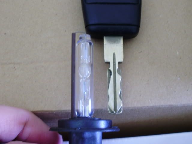

This is the HID bulb before it fit into my car.

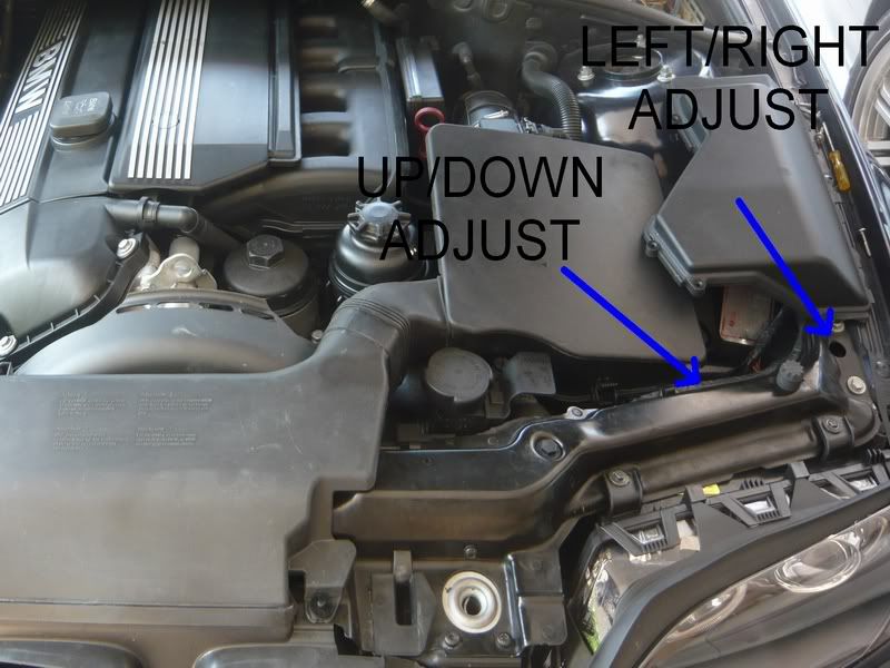

By the way, how to adjust high or low and also the focus? thanks
High and low is quite easy. Focus - cannot. You have to adjust the bulb. :eek:
For my E46, I adjust the head lamp as shown by turning the knob or use a philip screwdriver.

thanks, will check if E39 has the same hole for high/low adjustment.

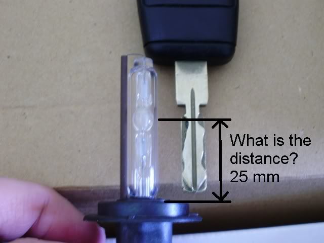

Hard to tell from the picture. you should measure the distance as shown below.

it not the length of the bulb for HID. It the location of the arc chamber. It is 25mm from the base to the centre of the arc chamber for H7 bulb.

No lah.. For halogen, it start from the bottom of the base to the bottom of the filament.
For HID, it start from the top of the base to the centre of the arc chamber.
A good way to compare is to put the halogen lamp and the HID side by side to compare. The location of the light source should be the same.
