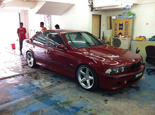

Rim : F10, Msport/M5
Front : 19 X 8.5 (et20), tyre 245/35/19
Rear : 19 X 9.5 (et20), tyre 275/30/19
Spacer : H&R 10mm each for front.
Roll fender : no
Susp. & Spring : Blistein Susp + HR Sport Spring
Pictures:

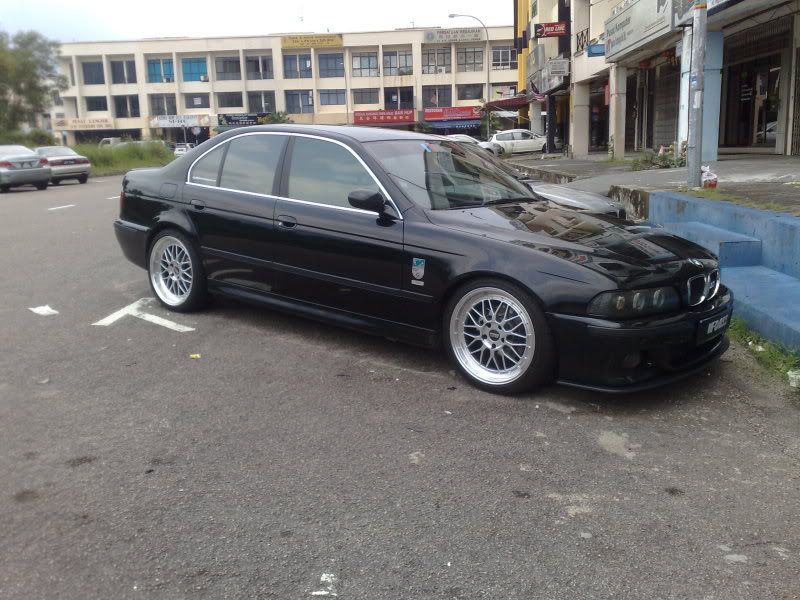

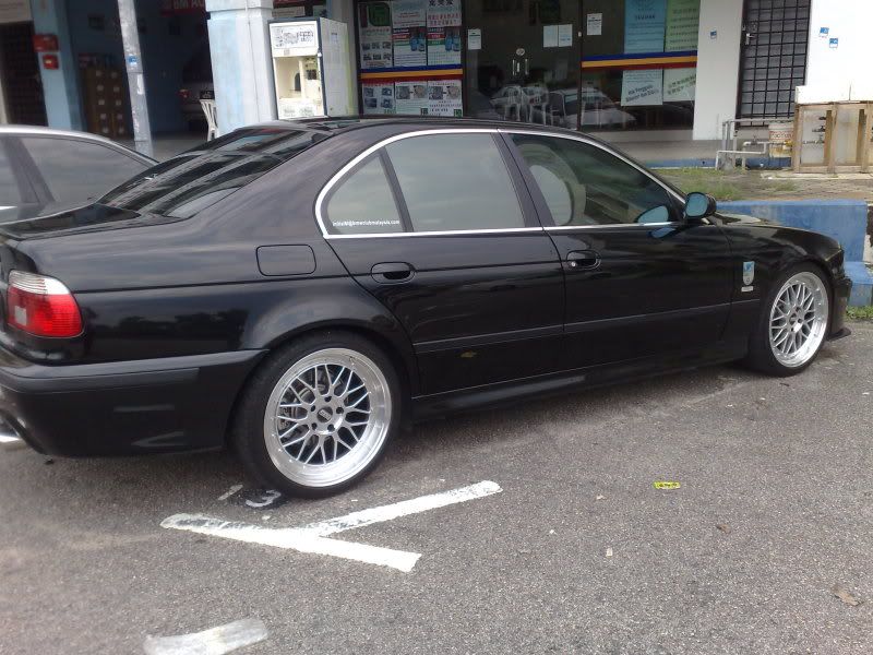

Rim : BBS LM
Front : 19 X 8.5 (et18), tyre 245/35/19
Rear : 19 X 9.5 (et22), tyre 275/30/19
Spacer : no
Roll fender : no
Susp. & Spring : Boge Sport & Eibach Sport
Pictures:
appreciate your effort nik...hope this would serve as reference our fellow e39ers..pending my et for frnt rims
wow..the rear can go until 275 !!! crazy stuf ! would be great if could see the pic from the rear to show how wide is the tire..

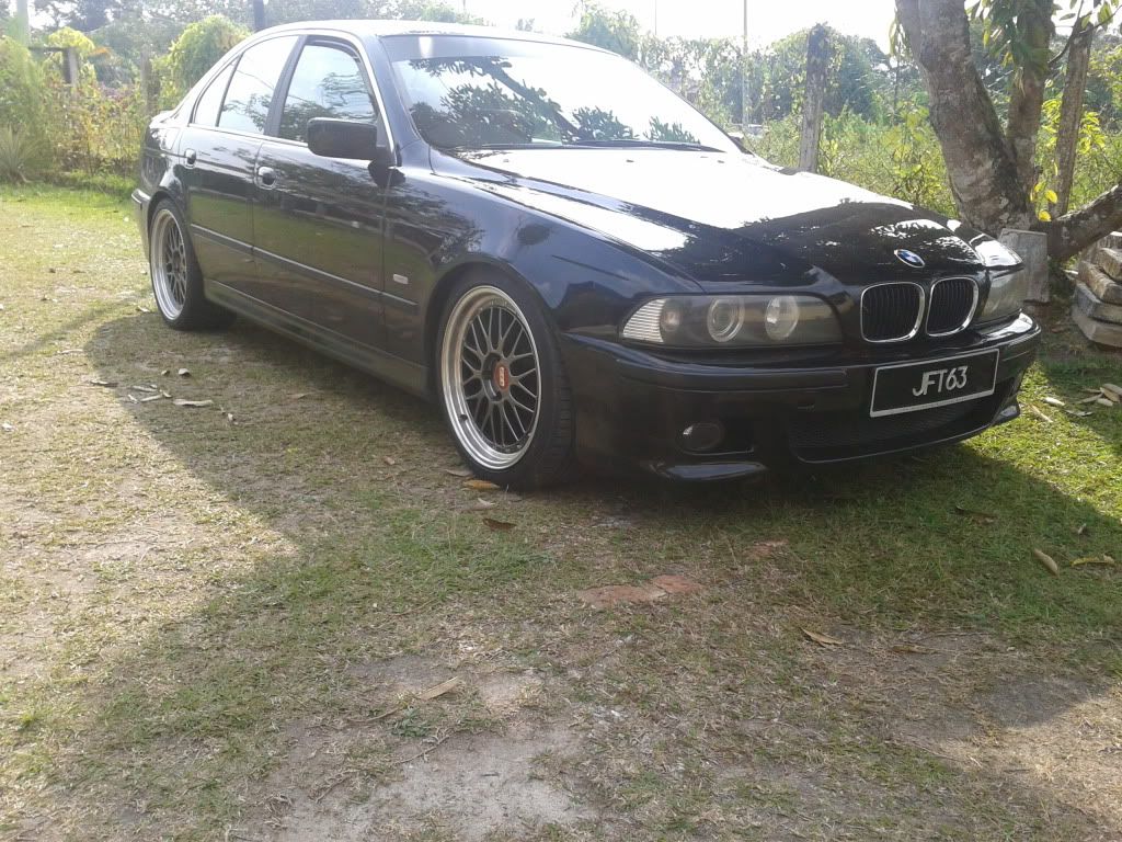

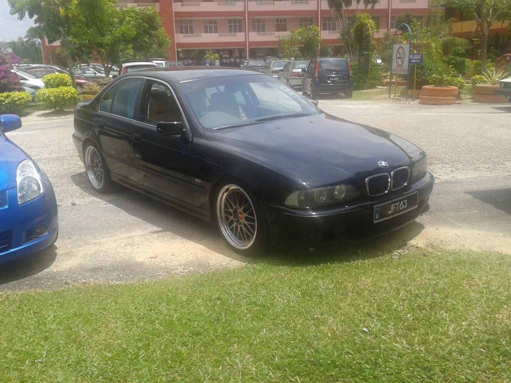

Rim : BBS LM made for E39
Front : 19 X 8.5 (et15), tyre 245/35/19
Spacer : no
Centre Hub : No centre cone. Perfectly fit E39 hub
Roll fender : no
Susp. & Spring : Bilstein B8 Monotube & H&R Sport

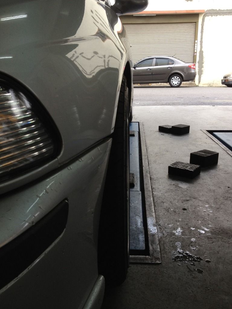

Rim : Breyton GTR
Front : 20" (et20), tyre 245/30/20
Rear : 20" (et22), tyre 275/30/20
Spacer : no*
Roll fender : yes**
Susp. & Spring : GAB SS Series (Full Adjustable)
Pictures:
attachment.php
attachment.php
Note:
* Though I am not running spacers, I think the front could use a pair to flush the front wheels out a bit
** Rolling the fenders is not necessary IMHO if you leave a normal sensible gaps (ie 2 fingers+). I decided to push the limit a lil' and if you run 0 finger stance, going up car park ramps is a b*tch without rolling the rear in.
View attachment 25601View attachment 25602
