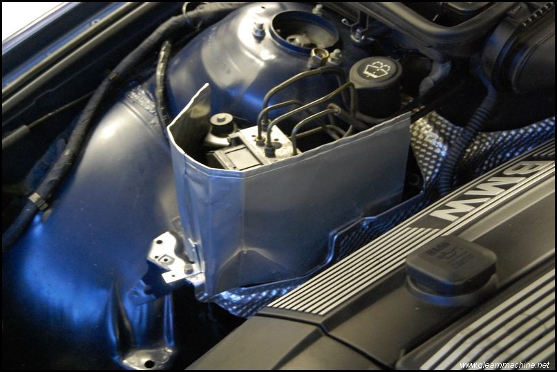

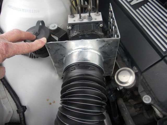

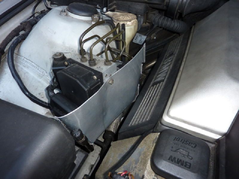

Abs failure in e39 is quite common due to the position of the pump near heat source (exaust manifold). The best way is change to new unit and put on heat shield to prolong the life of module. I was quoted by mechanics the cost of changing to new abs module n programming is rm 1700 - 2000.
Just my opinion.
Just sharing..
wah....i like the 4th pic from the top....got cooling duct summore.....but then over time dirt will be introduced.

thanks for sharing the info and the photos bro. likewise bro moots photo no 4 seems to be an attractive solution.
