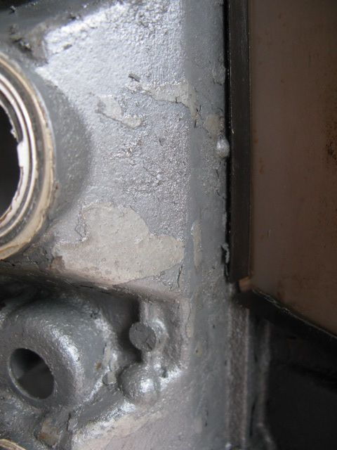

Open the valve cover and found out that the inner side of the valve cover's paint has already peel off..what should I do? will the debris enter the engine? According to Albert, it will not harm the engine as long as we regularly change the engine oil & filter...or should I find a new valve cover?
wah bro....dah tambah e34 pulak.....good lah you.
i would clean the mess by using a scraper and buang the flakes off as much as possible and then rinse them off with water.better if you could get a paint stripper....sumer keluar....can find the paint stripper kat hardware shop.but be sure it is suitable for the valve cover....
Aha...the 'flakes' are the correct word....thanks Moots...comes to my mind to do sand blast...but where?Tried using scrapper, but not much coming out...will try the paint stripper and see...

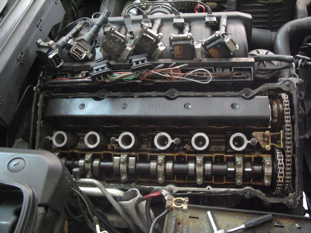

aisey....dah nengok gambar,lupa plak nak comment yang ni....small dabs of sealant is only required a 6 locations....eh wait a minute.this engine no vanos.so 4 locations...at the rear section at the half moon where the angle is acute.apply sealant on the head,not the gasket.small dabs only plse....
4 locations?..half moon 2, the other 2?.."sealant on the head, not the gasket" mean no sealant on the valve cover, right?just put small dabs on the head(half moon), and not along the head?.....
1- put small dabs of sealant on the head at 4 spot..half moon..
2- put the gasket on..
3- put the valve cover on top of the gasket...no sealant right?
what about the plug hole? no need sealant?...when I opened the valve cover, there are sealant on every plug hole and all along the valve cover...
Thanks again bro..you are my savior! :58: :smile:
Seen from the pictures, the previous mechanic put sealant on the gasket, not the head...
yes bro...sealant only on the areas i mentioned and no where else....
however on my m52 and m54 i offer the gasket onto the valve cover coz there are grooves or longkang on it to put the gasket securely before putting the valve cover onto the head.But your gambar,the gasket look like flat on both sides.maybe the m50 is like that and if that is the case you offer the gasket onto the cylinder head lah...
The mechanics use sealant to postively ensure there are no leaks so customers don't have to come back and they don't have to re-do coz time is money.Especially so for older cars where the valve cover may have distorted over the years and sealing may not be as good by just fitting the gasket alone.

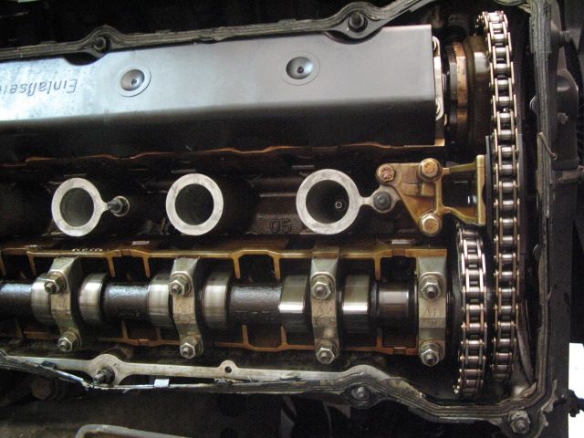

hi anakin... do you replace gasket on the spark plug area or also at the valve cover area? since i dont see a new gasket on your picture.. only notice the spark plug area are new gasket.. cheers!
Hi Max...long time no update from you..hows life? btw i did replace the spark plugs seal gasket, it comes with the set,but the rubber gasket/bush for the valve cover nuts have to buy separately, 15 of them..
