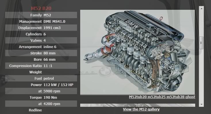

Have a look at the picture. Which one is your engine?
M43 engine
N42 engine
M52 engine

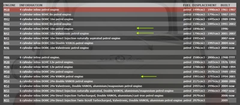

I don't see any obvious mechanism to alter the camshaft angle in the N42, unlike in the Vanos equipped engines...
Valvetronic alters the intake valve lift and duration. but does nothing to the camshaft timing...
