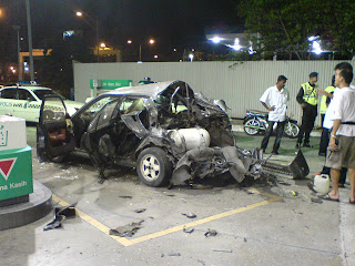

MALACCA: Two brothers who converted a cooking gas tank into a natural gas kit for their van paid dearly when it exploded, killing one of them.
Mohd Hailmi Ishak, 25, from Kampung Duyong, and his brother Rosli Ishak, 30, from Taman Tiang Dua, had stopped at a Petronas petrol station in Batu Berendam at about 7.50pm on Friday to refuel.

Merz at Kepong (notice the NGV tank is still ok but the cooking gas tank kaboom)

NGV tank is designed to take up pressure of 3,000 psi hence it is heavier at ~ 45kg and more expensive ~RM1K
LPG tank is designed to take up pressure of 60-120 psi (lupa lah dah lama tak buka kitab) and lighter ~ 20kg and cheaper (RM150?).
From the newspaper reports, I deduce that they had fitted an extra tank (LPG) to their NGV system. The NGV filling is done at 1,500 psi and LPG tank can only take up 120psi, even if there is an overpressure valve fitted, I think it could not take up a sudden surge of 1,500 psi, which is more than 10 times it is designed for.
